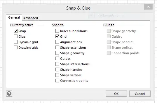

I haven't found an actual command in Visio 2013 to auto-align connection points, but the following work around should provide the results you need:
Bring up the Snap & Glue window (Alt+F9) and ensure the Snap option (under Currently Active) along with the Grid option (under Snap to) are checked in the General tab. The shape's connection points should now snap to the grid. This will allow you to align and space the points as required.
Snap & Glue window
