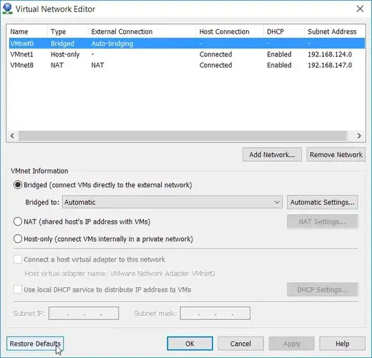

You don't need to necessarily reinstall VMware. You might lose custom config and preferences, if you do so.
Here is a simple fix
  • Edit > Virtual Network Editor
  • Grant Admin Privileges
  • You shall see all network adapter to configure, tweak those to your needs
  • If you don't know what those are, simply click Restore Defaults

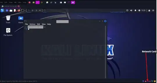

In Linux you should use this command in terminal:
sudo systemctl start vmware-networks
and make sure the network enabled by checking out network option below in VMWare application. Checkout the screenshot:
Screenshot NIC
