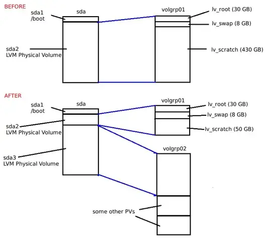

I have a drive, sda. It has two partitions:
sda1: /boot
sda2: LVM managed in Volume Group volgrp01
volgrp01 contains the following Logical Volumes:
lv_root (30 GB)
lv_swap (8 GB)
lv_scratch (430 GB)
What I want to do is reduce lv_scratch to 50 GB, and re-allocate that newly freed 380 GB into a new partition, sda3 (which I'll then add to another Volume Group).
I've attached an image of my desired BEFORE and AFTER. I'm right in the middle of learning about LVM, and while I can grasp the idea of resizing Logical Volumes within a Volume Group, I'm unsure of how one would re-allocate that space into a new partition.
I'm using RHEL6.
