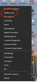

All you have to do is to search for Windows Utility Center or Mobility Center. To get this option press Windows+X which gets you a a popup menu in the left corner of the screen. From there select Mobility Center or Windows Utility Center, and from there assign for your function keys.
Screenshot
