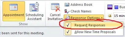

You can prevent meeting request replies
Even if you don't turn off the response option when you initially send the meeting request, you can change the option at any time.
- Open the meeting.
- On the Meeting Ribbon
- In the Attendees group, click Responses.
- NOTE: For recurring meetings, the Meeting tab appears as the Recurring Meeting tab.
- Uncheck Request Responses
- Click Send Update (It is necessary to click Send Update so that the meeting request is updated in Outlook for all meeting attendees)
