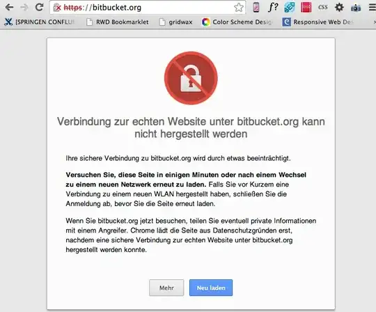

But when I try to access github.com or bitbucket.org through chrome I get the following:
HSTS failure
certification failure certification failure
Unfortunately it's in german but in short it says that the connection is affected by something. The failure type is HSTS failure. The second screen says that the certificate was signed by a unreliable deliverer.
I'm using Chrome (34.0.1847.116) on a Mac (OS X 10.9.2 (13C64)).
Any suggestions what could cause this issue or how to solve it?

  • Pretty sure this is Heartbleed – w00t Apr 10 '14 at 06:55
  • @w00t But as far as I understand the Heartbleed bug there ought to be something wrong on the github server. And these seem to be fine: http://filippo.io/Heartbleed/#github.com Or am I wrong? – damian Apr 10 '14 at 08:23

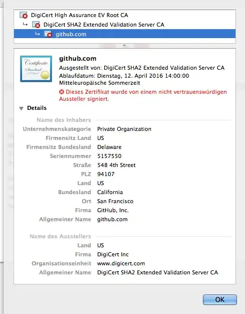

  • Click on the lock next to the https:// and then you can inspect the certificate chain and see which cert is invalid. – w00t Apr 10 '14 at 08:24
  • @w00t Updated my question. It's quite strange that the Mac Keychain Access doesn't show any invalid certificates... Also there is no issue when using any other browser (like Safari). – damian Apr 10 '14 at 08:38
    Click on the first cert and see why it's not trusted. It's still trusted on my phone... – w00t Apr 10 '14 at 08:44
  • @w00t The first certificate says that it was signed from an unknown instance. `Entrust.net` – damian Apr 10 '14 at 08:46
  • I'm beginning to think you don't have any trusted certs in your key chain any more... Start manually adding the ones that you trust :-) – w00t Apr 10 '14 at 08:47
  • Err what? For me the top cert is from digicert.com, not entrust.net... – w00t Apr 10 '14 at 08:50
  • The owner is digicert.com but the originator is entrust.net (see screen above) – damian Apr 10 '14 at 08:52
  • On my phone, there is no reference to entrust.net anywhere. Sorry, I can't cut paste the fingerprint but the sha1 starts with 5f and ends with 25 – w00t Apr 10 '14 at 09:28

  • delete false certificates
  • will be correctly recreated by system on reboot
mrhell
  • 64
    Removing the certificates solved it for me... Danke! – damian Apr 16 '14 at 07:54

The steps that worked for me:
  1. Open Keychain (Applications / Utilities / Keychain)
  2. Go to Presentation -> Display expired certificates
  3. Find the "DigiCert High Assurance EV Root CA" certificate
  4. Close Chrome
  5. Download back this certificate from : https://www.digicert.com/digicert-root-certificates.htm
  6. Drag it to your "Session" keychain
  7. Restart Chrome
  8. Go to github, should be solved!

This is what worked for me (mac, not able to open github):
  1. Open Keychain
  2. Select "View" -> "Show Expired Certificates"
  3. In the search box, type "Digi". This should be enough to show any/all DigiCert certificates.
  4. Delete any certificates that have a red "X" icon (these are expired).
  5. Navigate to / reload GitHub. You should be allowed access.
Worth noting, I did not need a restart of Chrome or the OS.
