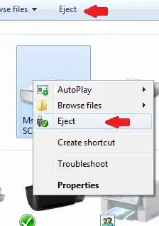

Everytime you hit that icon to "Safely Remove Hardware and Eject Media", it triggers the same process (in background) as opening Devices & Printers.
A relatively bigger no. of connected virtual and/or network printers and other devices may cause it to work slower.
If you could bear an extra icon in your taskbar, here's a work around (might be little annoying to keep) -
Go to Control Panel -> View devices and printers. Whatever time it takes to open is its one time thing. If you could keep this window minimized (maybe to the very left) on the taskbar, it can save time while trying to eject devices.
Going forward, whenever you connect a device, OS would update this window (devices and printers) in background and would keep it synced. And when you click this icon enter image description here it's gonna work faster.
Alternatively, since you have that Devices and printers window opened already (though minimized), you can restore it, click on the device and choose to eject. (two ways as in below image).
Good luck.
d-coder
  • 155
  • This is not correct. The "Devices and Printers" display (and Device Manager) work on data that already exists (a tree of structures called Device Nodes). "Safely remove hardware" takes longer. So does "Scan for hardware changes" in Device Manager. – Jamie Hanrahan Mar 13 '19 at 21:33
