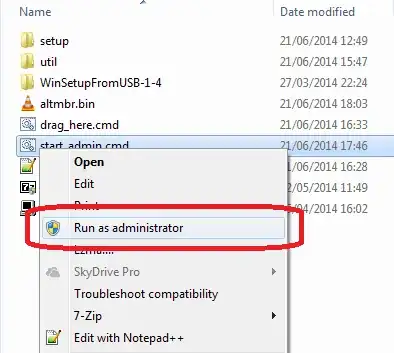

    7. Go to folder from step 1 and run start_admin.cmd as Administrator. This is crucial for its operation, right-click it and select Run as Administrator: Run as admin
    8. It is going to ask you for disk number and bootable partition number (step 2.4). Re-open Disk Management and find those numbers like you did in step 2.4. Specify the respective numbers and press Enter.

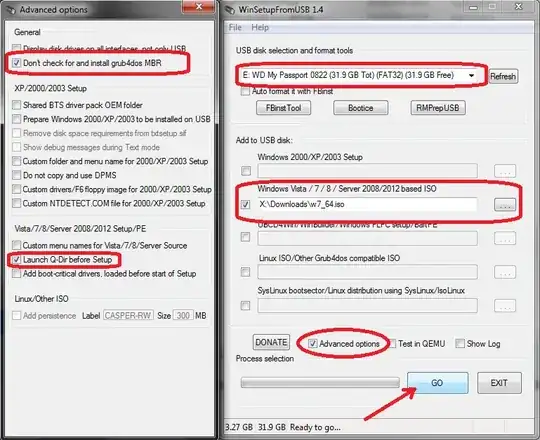

  4. [ Adding Windows-based installers (WinSetupFromUSB) ]
    1. Back in the same folder, go inside WSFUSB folder (not WinSetupFromUSB folder) and run WinSetupFromUSB.exe appropriate for your system architecture.
    2. Choose your partition in the topmost dropdown menu. Make sure to do it carefully.
    3. Check the box next to Windows 7/8 installer and click the button on the right to select your Windows installer .iso.
    4. Select the Advanced options box. Make sure that Don't check for and install grub4dos MBR and Launch Q-Dir before Setup.
    5. Double-check your settings and make sure they look almost 100% identical (except disk and .iso path) to this example: WSFUSB
    6. Optionally, you may select Custom menu names for Vista/7/8/Server Source so that you are able to see custom names when selecting Windows distributions at boot time.
    7. When you are ready, press GO button. If you selected the box from step 4.7, it's going to ask for the names. After that, wait for the operation to complete.
    8. Repeat the steps for each Windows distribution you want to add.
