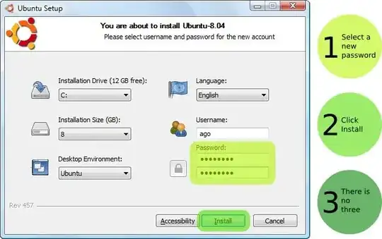

You can have both XP and Linux on the same disk, by using Linux as an application within Windows. This way, you don't disturb XP at all.
I suggest the Wubi linux distribution, since it's a variant of the very popular and easy to use Ubuntu Linux:
Wubi -- an officially supported Ubuntu installer for Windows
harrymc
  • 455,459
  • 526
  • 924
  • Simple great tool. I just installed and my Linux is up and running. I never used Linux in my 10 years of programming life and now realise how great it is. – RPK Nov 23 '09 at 10:24
