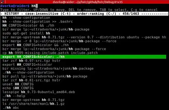

As navigation through history using Ctrl-r is IMO cumbersome, you may want to consider hh:
https://github.com/dvorka/hstr
which makes navigation much simpler, straightforward and efficient - including running the command:
Martin Dvorak
