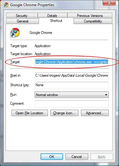

In case you don't know how to add flags in shortcuts, refer to this image where the --incognito flag is added:
