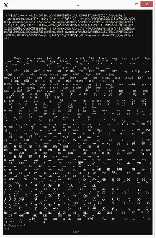

This is urxvt without tmux
no tmux
This is urxvt with tmux and utf8 not enabled in the config
tmux with utf8 enabled
This is urxvt with tmux and utf8 enabled in the config
tmux with utf8 not enabled
How can I make tmux act consistent with the initial result?

  • Where can I get that `glyphs` application to test the results? – Valmiky Arquissandas Jul 25 '14 at 02:23
  • The glyphs script is from this: https://github.com/lucy/tewi-font/blob/master/glyphs I've actually stopped having this problem a long time ago, with no action on my part. I installed Windows 7 since posting as well. – Hal Jul 29 '14 at 07:22
