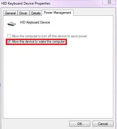

I might be a little unclear regarding your question. To my understanding you want to prevent a mouse/keyboard from waking your computer or does this include software? Sticking with the hardware you can probably use:
Device Manager > Keyboards > [Keyboard You User] > Right Click - Properties > Power Management
Untick "Allow this device to wake my computer". Rinse and repeat for your mouse.

    Unfortunately this won't actually work. This prevents the device from waking the *computer* from sleep, but it will not prevent it from waking the *monitor*. – zeel Apr 22 '14 at 23:53
  • @zeel | I might have misunderstood the question. Isn't the OP trying to prevent the monitor waking from a keyboard press? – Matthew Williams Apr 22 '14 at 23:56
  • Yes, which the method described above will not do. The power option keeps the device from waking windows from sleep mode - but it does not apply to the screen being asleep. Therefore devices set to not wake the computer will still wake the screen. – zeel Apr 23 '14 at 00:00

Device Manager lists for every device that can wake up your computer whether it's also allowed to. Microsoft
MSalters
  • 8,185
  • 29
  • Devices that can not wake the computer still *can* wake the monitor, so this won't help. – zeel Apr 22 '14 at 23:55
  • @zeel: No, that's not possible. The monitor wakes up when the videocard in the PC sends a signal, and that videocard in the PC obviously can't send a signal if the entire PC is asleep. There's no direct connection between the keyboard and the monitor bypassing the PC. – MSalters Apr 23 '14 at 07:24
