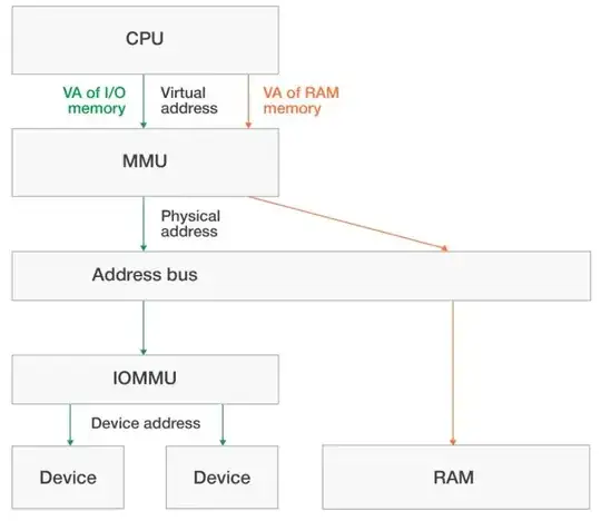

The address bus width determines the size of the physical address space. But not all the values within this space are claimed by memory controllers. Some are claimed by other types of devices. The BAR register implicitly encoded the address range size requested by the PCIe device/function. But where the base of this range is must be properly configured. Then the device can automatically claim the request with the address falling into its range. This arrangement is all configurable during the system initialization/boot phase.
An useful illustration:
From the perspective of a software engineer, I think the most important thing to know is not how all these plumbing is implemented for a computing architecture. But by what means the hardware resource is exposed to software. For x86 architecture, it can be memory address, or IO address.
