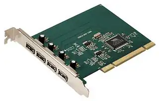

[USB Card]

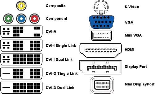

The following graphic shows the different types of output connectors that can be found on a graphics card.
video connector comparison
[Different types of output connectors]
As you can see USB is not on the list of output connectors. Before portable USB monitors the only option was to buy a USB to HDMI/VGA/... adaptor. Using USB to output to a display device is relatively new and while Windows and Mac have drivers that support these USB monitors, Linux has not quite caught up yet.
