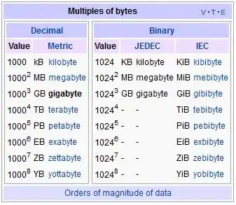

The wikipedia article Gigabyte describes how these terms were introduced into the international standards and furnishes the following table :
units
In 1998 the International Electrotechnical Commission (IEC) published standards for binary prefixes and requiring the use of gigabyte to strictly denote 10003 bytes and gibibyte to denote 10243 bytes. By the end of 2007, the IEC Standard had been adopted by the IEEE, EU, and NIST, and in 2009 they were incorporated in the International System of Quantities.
