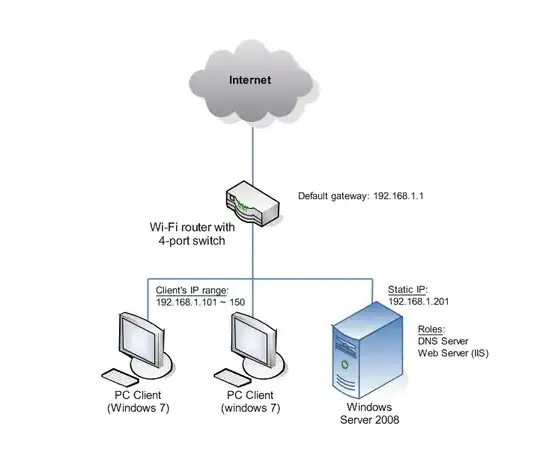

Network Diagram
I have a web site set up in IIS, mysite.net, which I want to be accessible ONLY from within my local network. So it's supposed to be an intranet site.
Now, the way the DNS server and the Web server are configured, when I go to "mysite.net" from the server computer, it all works fine; it's reachable. What I don't know how to do is to make this accessible from the clients computers.
PS: I can reach it from a client computer if I set preferred DNS server, on the router, to point to my server, but then I can't get to the web.
So, what am I missing? Is it a config to be done on the DNS server? On the Web server? On the router? Am I missing one or more hardware components?
Thank you.

  • Set up a Forwarder in your Windows DNS server that forwards all unknown requests to your ISP's DNS (or your router if it forwards requests, or use Google's DNS, etc.).
  • Set the clients to use the internal DNS server as their DNS setting.
This setup will cause the clients will check with the internal DNS, which will respond with IPs for any hosts it has entries for. Any other host requests (i.e.: Internet hosts) will be forwarded to your ISP's DNS for resolution.

  • In my DNS server, I have a forward lookup zone set up: mysite.net, so mysite.net is reachable. What I don't know how to do, is how to configure forwarders, since I get DNS servers dynamically from my ISP, through the router. This way I can't go to the DNS server and set a specific IP address to use as a forwarder. Any ideas on how to do that? You see, I just need to figure out the part between the router and my DNS Server. – fduayer May 08 '14 at 20:36
  • As it says in the answer: If your router supports DNS forwarding (which is most likely does), then just aim the DNS Forwarder (_not_ the same as a Forward Lookup Zone) at your router. You could also use your ISP's DNS server directly if you know it's IP, or just skip your router and ISP DNS completely and use a public DNS server, like Google's (8.8.8.8). "What I don't know how to do, is how to configure forwarders" - there's a link to steps about how to do that, right there in the answer. :) – Ƭᴇcʜιᴇ007 May 08 '14 at 20:53
