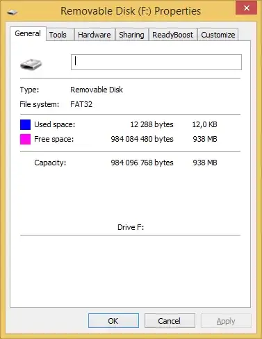

After writing the FreeNAS IMG to a 16 GB USB flash drive, I can now only use 938 MB. I used the Win32 Disk Imager tool to write the IMG to the device. Then later, when I inserted the the USB drive into my Windows 7 computer it said that it had to be formatted, because it couldn't read it. I believe this is normal. So I formatted it inside Windows using the format option when prompted. So in Windows Explorer now, 938 MB is reported as capacity of this device.
a
Also, when i check the properties dialog box I can see the same numbers.

I managed to do it with diskpart. What I was missing is the command to create a new partition. So here is a run-down of all the commands I used, step by step.
Beware that when typing select disk 1 (step 4), your disk number may be different. Selecting the incorrect disk might erase your whole computer's main disk drive, losing all your data on it.

When you write an image to a flashdrive, it will create the partition based on the specifications on the image. In your case it creates a partition of 938 MB.
Because flashdrives will only show the first partition, you cannot access the rest. However, using computer management->Disk management, you normally can increase the partition and include the unallocated space. Seeing your image, it may not be possible with this particular image unless you somehow made an error when trying to flash the image.
Try to remove all but the F: Partition, then right click it, and use enlarge.
It is possible the image won't work anymore, but you can always delete all partitions and flash the image again.
