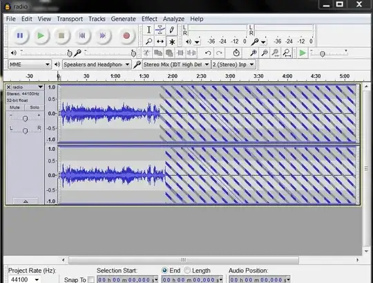

What is Audacity doing with a compressed format when importing an mp3 or flac into it?
It looks like it is extracting it
When I open a wav file, it looks different - it just processes for a second and it's there:
What happens? What is the difference? Is Audacity processing the mp3 or wma after having converted (extracted?) them as wav?
