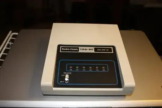

According to the above specs, in order to connect this properly you would need to find the original 1200 baud modem listed in the PERIPHERALS section and connect using dial-up. 1200 baud = 1200 B/s. You will need something similar to the device shown on image below:
TRS-80 Modem DC-2212

    The fact that weren't faster modems at that time, doesn't mean that the serial port itself can't do higher speeds like at least 38400 bps. – Cristian Ciupitu May 28 '14 at 20:08
  • @CristianCiupitu I'm not disputing that, but if the OP wants authenticity like me, he would stick with the modem. – eyoung100 May 28 '14 at 20:11
    I think that this might actually be the most promising Option. I would start with a "not that authentic"-variant with a newer modem and if I stumble upon an matching modem I would "downgrade" to that. Do you think that drivers might a problem? I have not worked with modems in ages. Do the just talk AT commands over RS232? – Clemens Bergmann May 28 '14 at 20:18
  • @ClemensBergmann, You're forgetting something here though. With the limit in RAM(640k + 128k add-in), your not authentic variant must be between 300 baud and the 1200 baud pictured, and must be external, unless the internal slots aren't used. Even internally, the speed can't be over 1200 baud. – eyoung100 May 28 '14 at 20:23
    1200 baud and 1200 bits/sec are for all intents and purposes the same. So about 150 bytes/second, give or take. The four hours use time on battery is pretty impressive, though, all considered. – user May 28 '14 at 21:15
  • @ECarterYoung that means I need a 1200 baud modem or can I use a faster modem in a slower mode? Also do you have experience with using modems in DOS? I am way to young (1985) to have used these in a decent manner. Do I understand it right that I would need a modem that has some kind of driver available for my old DOS or are these mostly interchangeable. – Clemens Bergmann May 29 '14 at 04:56
  • I don't believe you can slow down a faster modem these days. I could be wrong. – eyoung100 May 29 '14 at 13:48
  • Now, how would I connect that 1200 baud modem to the 1920 "candlestick" telephone on my desk? I think they would go together so well! :) (If I still worked in a cubicle, I'd love to put one of those phones on my desk just to confuse the iPhone-packing kids!) – Phil Perry May 29 '14 at 13:59
  • The model pictured above has no cradle. See [this WikiPedia on Modems](http://en.wikipedia.org/wiki/Modem) to see the answer to your question. – eyoung100 May 29 '14 at 14:03
  • @ClemensBergmann a good terminal emulator knows how to talk to the hardware to do the necessary buffering so you can run much faster than 1200 baud. – Thorbjørn Ravn Andersen May 29 '14 at 14:40
  • According to http://www.8bit-micro.com/tandylap.htm the 1400LT *has a built in modem* – James May 29 '14 at 20:44
  • @James The Listing was for an HD, not an LT. The OP needs to clarify – eyoung100 May 29 '14 at 20:58
  • The HD has one floppy and one hard drive, so it's not an HD. I reckon that is in fact a 1400LT and does have a modem, but it could be a 1400FD (which doesn't). More specs [here](http://support.radioshack.com/support_computer/2512.HTM). – James May 30 '14 at 05:02
  • @vaxquis, It's fixed... – eyoung100 May 30 '14 at 13:59
  • Ok lets argue ove three hundreths of a byte... I added a tilde... are you still going to knitpick.... See http://www.physics.udel.edu/~watson/scen103/projects/96s/thosguys/baud.html – eyoung100 May 30 '14 at 14:03
  • I won't argue oveR three hundreD byteS... Though I probably could still **nitpick**... ^_^ btw, what's with the link You provided? –  May 30 '14 at 14:10
  • Using that link allows you to convert baud to bits/sec – eyoung100 May 30 '14 at 16:45
