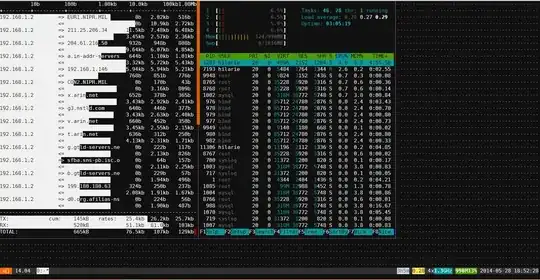

My new server install looks odd: enter image description here
is there anyway to resize it to use the whole terminal window?

This means that there is another ssh or terminal client, other than yourself, connected to this session, which has a smaller window size than yours.
You can detach all clients but yourself, using this Byobu hotkey:
Alt-F6
Or you can run the script /usr/lib/byobu/include/tmux-detach-all-but-current-client
Full disclosure: I am the author and maintainer of Byobu.

Alt-F6 did not work for me. But I found that I was using tmux. To detach the other window use a combination of list-clients and detach-client:
% tmux list-clients
/dev/pts/1: 0 [64x160 xterm] (utf8)
/dev/pts/39: 0 [39x143 xterm] (utf8)
% tmux detach-client -t /dev/pts/39
Since the 64x160 is larger, I figured that was my window while the other client was the smaller one.

I tried both the script (tmux-detach-all-but-current-client) and alt-F6. None of them worked. The terminal only went fullscreen for a couple of seconds, then it went back to small size (like in the image in the original post). I also checked users with w, it was only me logged in.
What ended up working for me, was simply disabling Byobu and enabling Byobu again, with a logout/in in between. Like so:
byobu-disable
exit
Login again
byobu-enable
Screen is back to normal.
