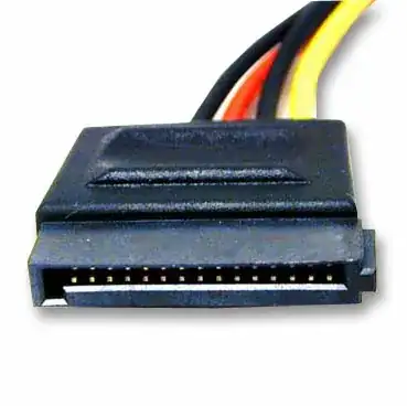

As some of the other answers suggest, this appears to be coil whine. I occasionally experience the same issue and was determined to find out what the cause was. I removed my Samsung SSD830 and attached it dangling from an eSATA cable outside the machine so I could place my ear next to it.
It was the hard disk.
I was a bit puzzled by this, seeing as there are no moving parts in an SSD. I wrote a CPU bound program to reproduce this behaviour and could see that the HD was idle during the run. This puzzled me further. However, it turned out that this behaviour manifested itself only when the laptop PSU was disconnected and the machine was running from battery only.
It may be that when CPU load increases, there is not enough current available to power all components without a voltage sag in another component, hence causing the behaviour you have experienced. Powerful GPUs and CPUs crave current like a flux capacitor, so it may be you need a higher-rated PSU to deliver enough current during load spikes.
Note This is all conjecture and just based on guesses, so don't go and buy another PSU without confirming the source yourself. This may however help you track down the source of the issue.
  • I've had two SSD's. Both have made whining noises. I've done the same as you - put them on a cable and it's definitely the drive that was whining. You just have to be in a quiet enough room to hear it. – Chris Nevill Jun 04 '14 at 19:26
  • Thanks for confirming my suspicion. Still haven't been able to find out which component in the SSD could possibly make the sound though, have you? Searching on the Internet only gives you ignorant answers such as there is no moving parts.. – timss Dec 06 '14 at 00:00
