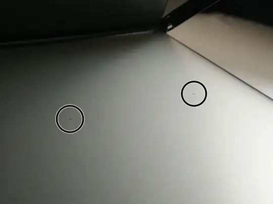

This summer my flat was "attacked" by hundreds of tiny thunderflies, some of which managed to get behind the screen of my LCD. A few of the cursed creatures went and died right in the middle of the display:
a thunderfly enters the LCD
And yes, this is real. Imagine my surprise when I saw one of these things crawling across the monitor, tried to swat the thing and realized it was inside!
How do I go about removing them?
I have tried tapping the screen and shaking it but to no avail. They are very annoying to look at because they look like groups of dead pixels, or even (.) characters.

I had a bug directly in the middle of my monitor and I removed him by disassembling the monitor.
So there are four layers in your monitor:
  • backlight
  • diffuser
  • LCD
  • front facing outermost protective plastic/glass layer
I thought the bug was right behind the first layer, between LCD and glass. However as I found out these two layers are permanently glued and sealed. That's a good news as no bugs get in.
I found the bug (actually 3 of them, two that I didn't know of) between diffuser and LCD. This space can be quite easily reached with just basic tools (pry tool, flat and Phillips screwdriver) within 30 minutes. You can follow detailed steps in Acer Thin Bezel Monitor Disassembly.

    I want to thank you SO SO much. Thanks to your answer and iFixit guide i dared to take apart my Mi curved 34 inch monitor very carefully to remove some big dust piece that was stuck RIGHT IN THE CENTER of the screen. Turned out it was stuck between the first and second diffuser layer, and now ITS GONE! I'm so happy right now! Thanks! – Epskampie Jan 16 '21 at 12:45
  • Great answer. Should have more upvotes! – slugmandrew Aug 26 '21 at 12:22
  • Just did this on an LG monitor and although it was not simple, it was also not as bad as I feared. Getting the snap together parts to open up was the hard bit. And that's both detaching the outer case and also an inner metal case that also clipped shut around the parts. After that it was exactly as described above. The LCD layer isn't attached to the backlight/diffuser, so you can just hinge the layers apart and wipe off the bugs. Everything working perfectly again now. I used a guitar pick as the pry tool BTW. – Matt Gibson Jul 07 '22 at 12:48
