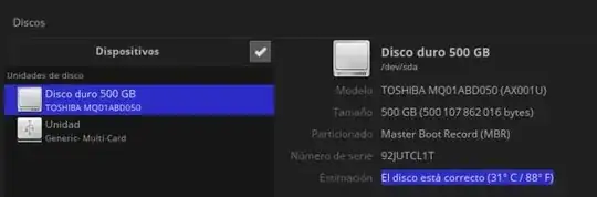

  3. You can also use that live image to check your HDD's status and SMART data with the gnome-disks app to know if it's ultimately faulty/prone to fail.
    • You may need to install these apps, so in case they're not already there you may run apt-get install gparted gnome-disks from any terminal emulator.

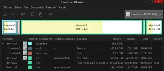

  4. Once you've made a backup of your data you can create a new partition table and wipe your HDD completely with gparted.
This is Gparted Gparted
This is the Gnome Disks Utility Gnome Disks The blue selected text is where you'll be warned in case your disk is failing (the text would even be red). You can run SMART tests from that app too.
