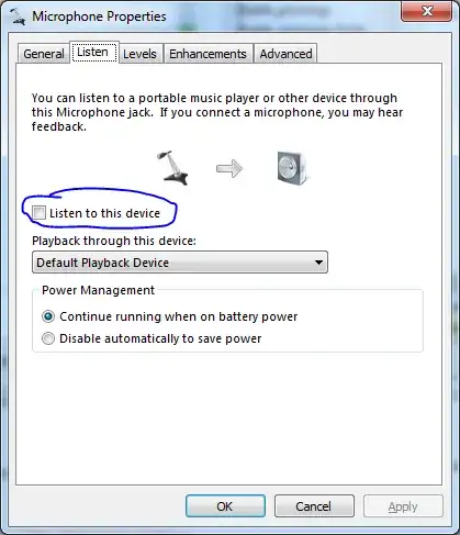

I am unsure exactly what you mean, however, if you are saying that what you say in to your microphone is coming out of the speakers then do the following:
  1. Right click on the audio icon near the clock.
  2. Click "Recording Devices"
  3. Double click on your microphone Device.
  4. Click the "Listen" tab.
  5. make sure that "Listen to this device" is unchecked.

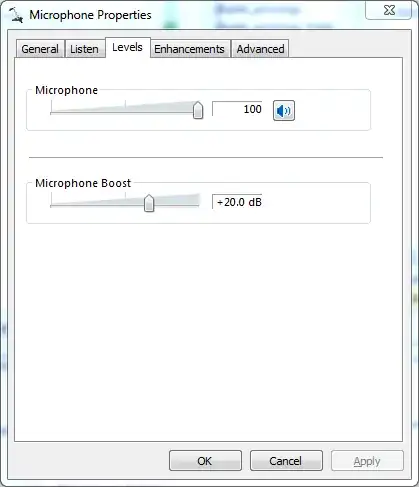

If you are saying that you want to edit the boost / sensitivity level, do the following:
  4. Click the "Levels" tab.
  5. Move the sliders accordingly.

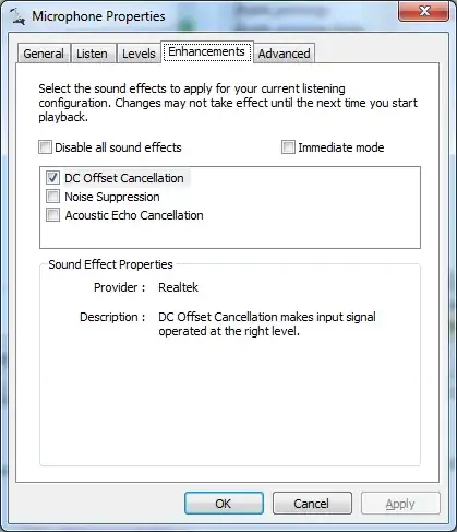

Lastly, if you are still having problems, you may want to try a combination of "Enhancements" such as "Noise Suppression". To do this:
  4. Click the "Enhancements" tab.
  5. Tick the boxes accordingly.
