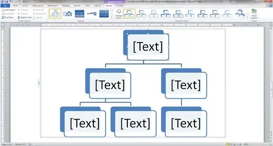

How do I create flow charts in LibreOffice writer? I know how to do it in Draw but I'd like to do it in Writer as well. (I'm looking for functionality close to Word's Smart Art feature)
Here's an example of what I mean and how it works in Word:
