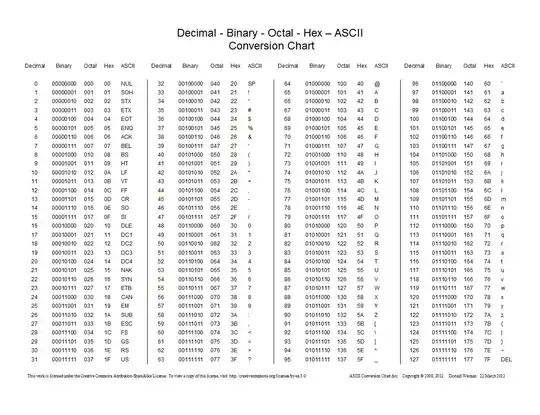

Here is a chart showing conversions between decimal, hexadecimal, octal, and binary: Hexadecimal Conversion Chart
