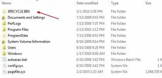

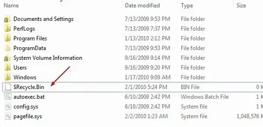

That is pretty easy to be avoided:
Delete the folder, open Notepad and save the blank file as $Recycle.Bin in the root directory of the drive in question, now Windows cannot create the folder.
If you want to use the Recycle Bin again on this drive, just delete the file.
    This is not a solution because Windows just re-creates the bin on *every* drive the moment any operation access it on *any* drive (e.g., if you delete a file on `C:`, then Windows creates the bin folder on **every** volume). This is unacceptable because it makes it effectively impossible to do data-recovery because Windows is writing to the volume for no reason. – Synetech Oct 28 '12 at 20:51

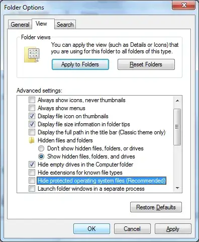

  1. Hide operating system files in "Folder and search options":

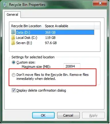

  2. Make sure deleted files do not get copied to the Recycle Bin (by right-clicking it):

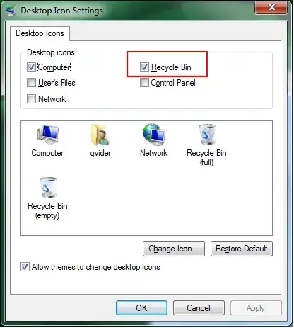

  3. Hide the Recycle Bin by personalizing the desktop:
