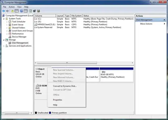

    I fired up Windows 7 Ultimate RC in VirtualBox and I was able to create a RAID1 mirror and boot from it. After adding three more drives I was able to verify that I could create spanned and striped volumes as well - though I did not have a chance to try and create them then reinstall on that newly created volume for attempting to boot - though honestly booting isn't that interesting from those types. I also tried the RAID5 support and it is greyed out in the GUI and DISKPART told me it was not available with this version of windows. Accepting this answer. – Goyuix Aug 01 '09 at 01:17

It's a bit late now, but here's a screenshot in Windows 7 Ultimate:
Windows 7 disk management
