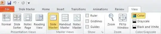

It sounds like it is saved in the slide master. This should work (although I am by far not a PowerPoint expert).
In the ribbon click on the "View" tab, and then click on Slide Master
The left hand side preview should update, and you can now click on the first slide (which is the master slide). Right-click on the first slide and select Master Layout. Select the footer checkbox, and click ok.
The footer should now be accessible to you in the master slide for updating, which when updated will be inherited by the rest of your slides. Once done editing, click on 'Close Master View' in the ribbon, and that should be it.

    Just to add: the footer might be on either the slide master (the top thumbnail in the list as you've described) or it might be on one/any/all of the slide layouts (the slide thumbnails indented under the master). – Steve Rindsberg Jun 14 '14 at 21:17
  • Even with this explanation, I still couldn't figure out how to change the Footer. The Master has my footer, but the template I am using still has the "Presentation title" footer. – Chris Nielsen Mar 31 '17 at 20:37
  • PLUS, If you are printing handouts (like two slides to a page) there is also a Handout Master on the View tab which you can go into and try remove these elements. We found the print dialogue box was still printing data like a date even if this element was unticked! – micstr Apr 19 '17 at 14:24
