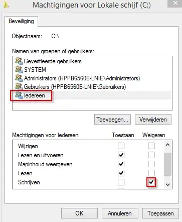

If your stick uses the NTFS filesystem, you can do the following. If not, consider copying the files off of the drive, then format as NTFS.
Do the following:
  1. Open your explorer and select the driveletter of your USB drive.\
  2. Right click and select Properties
  3. Open the tab Security
  4. Click the Change button, and answer yes to the UAC prompt if applicable.
  5. Look if there's an Everyone user. It is likely not there. If it is, skip step 8.
  6. Click on Add...
  7. Type in Everyone and click Ok
  8. Select the Everyone user
  9. Set a checkmark in the column deny for Write.
From this moment on, no one can change the drive anymore. If you want to make changes, Repeat the above steps and remove the checkbox for write in the deny column.
Although the screenshot is dutch, it is showing the endresult.
