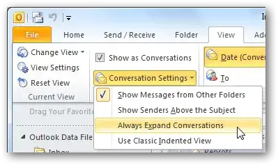

When users connect to the Exchange Server (using local LAN) though Outlook 2010, this warning is shown (in italian):
Outlook certificate mismatch error
Translation: it says that the certificate is issued by an authorized provider (VeriSign in this case), the date is valid BUT there's a name mismatch (the name written on the certificate doesn't correspond to the server's name).
If I press the "Show certificate" button (the last one in the picture above), the certificate associated with IIS is shown: how can it be possible? I mean, it should only be used when connecting through Webmail.
