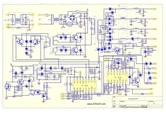

pic
In the above image there are 3 different types of "grounds" (3 different symbols) and they are not connected to each other:
  • ground of the case (power supply) connected to the "ground" wire on the wall outlet
  • ground on high-voltage DC side (looks like triangle)
  • ground on low voltage DC side (look next to each DC output - capacitor is connected there)
So, motherboard is NOT "grounded" by power supply: it is NOT connected to the "Ground" wire (NOT connected to the "ground" on the wall outlet). It is connected to it's own "low-DC-side" ground which is isolated from the outside world.
