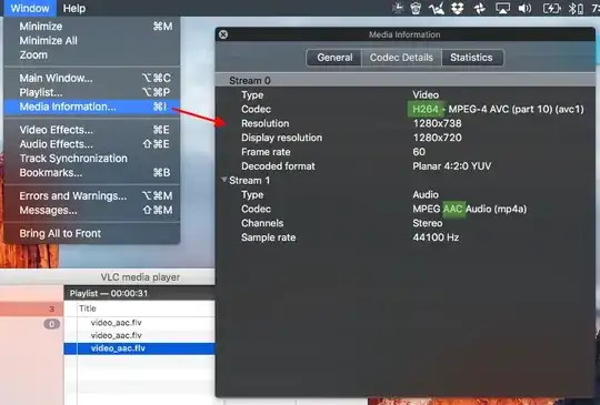

2.VLC's Media Information window: VLC's Media Information window for a flv file with AAC and H.264
This .flv file contains H.264 video and AAC audio which happens to be the correct formats/codecs for the .mp4 container.

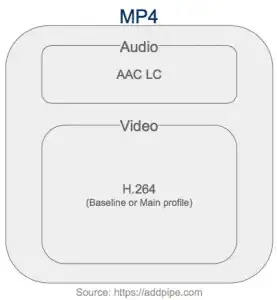

Here's the structure of such an .mp4 file:
mp4 file containing AAC audio and H.264 video
*Image courtesy of Converting FLV to MP4 With FFmpeg The Ultimate Guide
