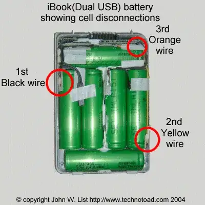

Lastly, if you are using a battery pack that uses standard cells, you can replace them yourself if the manufacturer wants a fortune for a new one. A friend's laptop was getting about 3-4 minutes of charge and Sony wanted to charge £290 which is ridiculous as you are better off getting a new netbook for that! I opened it up and replaced with identical cells which costed around £25. For example, here is the inside of an Apple battery:
Alt text
Peter Mortensen
