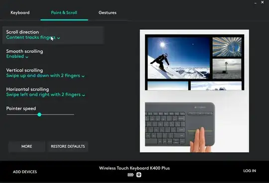

  • In late 2020, Logitech Options allows this configuration, at least for the Logitech K400: https://support.logi.com/hc/en-us/articles/360025297893 – DeeJayh Aug 22 '20 at 19:51

In late 2020, Logitech Options allows this configuration (at least for the Logitech K400, which DOES answer the OPs question)
Logitech Options
