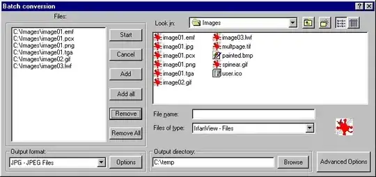

IrfanView has excellent batch processing abilities.
Irfan View
IrfanView also supports command line operations
i_view32.exe c:\myimages\*.tif /convert=c:\images\*.jpg
Here's the link to Command line manual

  • The dialog is a little busy, but batch processing in IrfanView is powerful and pretty fast. – Michael Todd Dec 02 '09 at 04:32
  • That seems like an excellent way for exploration and for semi-automatic conversion. But would I always need to start IrfanWiew and bring up this dialog? Or can it done using command-line parameters or using some scripting? – Peter Mortensen Dec 02 '09 at 10:00
  • @Peter: IrfanView does support command-line parameters – Sathyajith Bhat Dec 02 '09 at 12:00
  • I have downloaded and installed IrfanView. But "/extract" is not working as documented using the sample TIFF file. It saves only one JPEG file (a composite). Perhaps IrfanView can not handle this kind of TIFF file. I have tried with ImageJ and it can do the split (but this is from the user interface.) – Peter Mortensen Dec 02 '09 at 15:38
