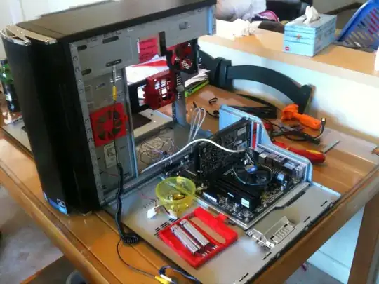

The OP found the Sigma Unicorn case,
It is an ATX. case pictured below, from this hardwaresecrets review. You see it open with motherboard showing on the open door that (as described in this tomshardware review) hinges downwards.
link

  • Found another _pure PC_ case searched as `"hinged door" "pc case"` Sigma Unicorn case [reviewed here.](http://www.tomshardware.com/reviews/pc-case-roundup,1951-2.html) – clt60 Jul 06 '14 at 08:48
  • @jm666 great find,there is a review on one page here http://www.hardwaresecrets.com/printpage/Sigma-Unicorn-Case-Review/566 and there is a pic of it open with motherboard showing here http://tinypic.com/view.php?pic=21cxbbb&s=5#.U7klEvldWqI and it is ATX according to that review.The manufacturer should really have used a pic like that and made it a selling point.That was 2008 and out of stock on newegg and I don't see any cases on the manufacturer site.But may be available here http://www.eio.com/p-29226-raidmax-unicorn-st-sigma-unicorn-black-10-steel-secc-atx-mid-tower-computer-case.aspx – barlop Jul 06 '14 at 10:56
