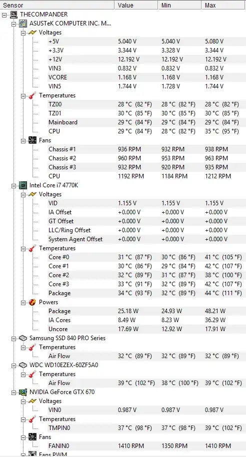

EDIT: CPUID HWMonitor Output
CPUID Output

    Thanks for this idea, I tested the PSU and there is no worrying variation on the 3.3V line, it hit 3.4V as a max. This is a nice guide to test a PSU when you don't have a spare, +1 – tekiwibird Jul 08 '14 at 09:21
