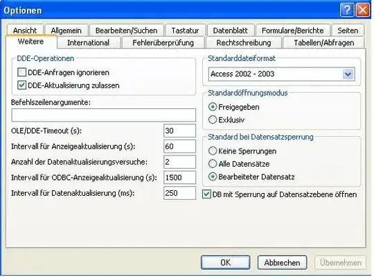

You could try the simplest thing: Tools -> Options -> Advanced -> Default Open Mode & check that it is set to Shared and that both Open databases using record-level locking and Edited record checked , but my experience just doing this in a multi-user environment is mixed. Sometimes works, sometimes not.

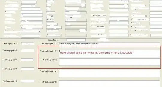

Taking a look at your image: if the form field in question maps to the same database record, then no, you can't have 2 people edit this at the same time. If the field maps to different records, then yes, it's possible.

  • First step is to determine if Text zu Gesprach 3 maps to completely different records or not when you're having the editing conflict. If your users are trying to edit the same record at the same time, then no, you can't do that in Access. You're done :-( Otherwise you can proceed with splitting the database into parts. – DaveParillo Dec 02 '09 at 16:20
  • In the Default Open Mode, the "Default Record locking" defaults to "No locks". Change it to "Edited record" & see if that works for you. – DaveParillo Dec 02 '09 at 16:22

  • @DaveParillo: please check the .jpg I attached again.The "Edited record" is it the 3rd one right? it's already checked and also the "Shared" in my case it says "Freigegeben" it's also checked... – tintincutes Dec 02 '09 at 16:30
  • Those settings *look* ok, but your english is **far** better than my german. babelfish gave me "worked on data record" which sounds correct. – DaveParillo Dec 02 '09 at 16:38

  • @DaveParillo: i just read your updated answer. when you say form field question, do you mean this field texts like: Text zu Gespräch 2, Text zu Gespräch 3, etc? i'm sorry i don't understand, what is the meaning of "map" here. do you have an email? – tintincutes Dec 02 '09 at 19:32
  • @DaveParillo: that's true, but he designed the database by himself he told me. – tintincutes Dec 02 '09 at 19:33
  • re: what I mean when I say 'maps to a field'. Is the box *Text zu Gespräch 3* on the form displayed in your picture associated with a single field in one record of the database? Another way of describing this: A table is (mostly) just rows and columns - does the text in *Text zu Gespräch 3* correspond to the intersection of **1 row** and **1 column**? If the answer is no, then you have a problem. – DaveParillo Dec 03 '09 at 00:40
  • @DaveParillo: i checked it and it seems the box "Text zu Gespräch 3" on the form is associated with a single field. I attached again a jpg file to see what i mean. is that the one you mean? – tintincutes Dec 03 '09 at 09:34
  • Yes, so you should be able to split this database. Make a copy before you begin. You should work with the person who originally created the database if possible. – DaveParillo Dec 03 '09 at 14:35
