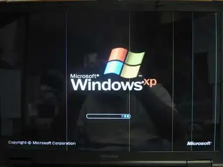

You probably have a variant of example 2 on this page: Laptop has bad video on the LCD screen. What is wrong?
alt text
This sort of thing is caused by a problem somewhere in the circuit that is common to the whole column of pixels. Could be a bad contact, shorted/broken connection, or a broken driver. If it's something simple, like a dirty connector or a cold solder joint, there might be a chance it can be repaired. If it's a blown driver, then it could be much harder to fix without replacing the whole LCD.
If pushing or flexing the screen or the ribbon connector makes the display change temporarily, then that's a good sign that it's a bad connection causing the issue.
user14068
  • 384
  • Exactly right. The one with the Windows XP startup screen looks identical but it's only one column and it's red instead of blue/white. –  Dec 04 '09 at 02:29
