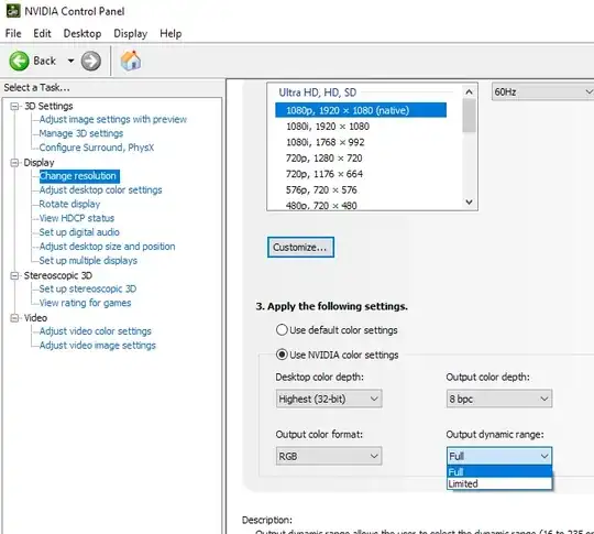

I have an ASUS VE278H 27" backlit LED monitor and NVIDIA GeForce 1060 running with Windows 10, and I noticed this issue recurred after some recent Windows updates, which I'm guessing reset the display settings to their defaults.
From the NVIDIA Control Panel I changed the Output Dynamic Range from "Limited" to "Full" and this fixed it for me (screenshot below).

  • "Beginning with Windows 10 Creator's Update (Redstone 2), the operating system controls these color settings. You can either use the Windows settings, or override them through the NVIDIA Control Panel by selecting the Use NVIDIA color settings check box." https://www.nvidia.com/content/Control-Panel-Help/vLatest/en-us/mergedProjects/nvdsp/CS_Change_Resolution_Advanced.htm – fantabolous Oct 01 '20 at 05:06

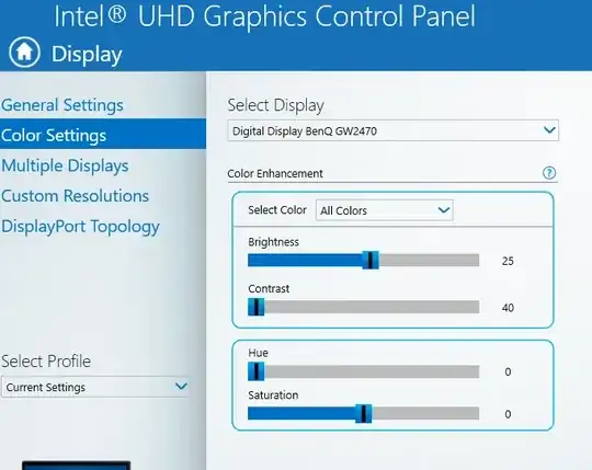

For everyone with Intel integrated graphics, who ended up on this page like me, here is how I got i fixed.
The default Contrast is 50 (on a scale from 40-100) and that washed out light colors on my monitor, at least when the monitor was connected through an usb-c dock. When lowering the contrast to 40 the light colors reappeared and I just had to increase the brightness a bit.

I have Windows 10. Go to control panel, system security and settings. Then type HD Graphics in the search box. Click on Intel HD Graphics. This will bring up your Intel Graphics Control Panel. Choose Display, then click the tab for color. Adjust brightness, contrast and Gamma to your liking. Hope this helped

As was mentioned before my comment, but with too little detail. With Intel UHD settings it is possible to turn down the colour contrast to bring out deeper colours.
The Intel UHD settings can be found by right-clicking the desktop and picking Intel Graphics Settings from there. You won't be able to find it from the Windows search option.
