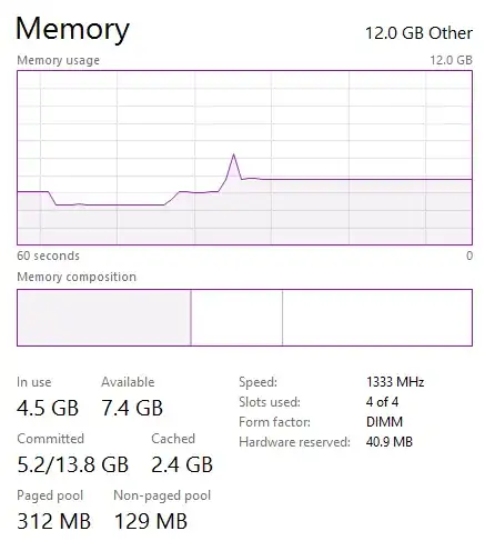

Below is an example from a computer with 24GB of RAM. Even though only 7 GB is currently allocated as "In Use" memory, another 10 GB is allocated as "Standby" memory and contains data that may or may not be read again. If it is read, it will make your computer "faster". The "Free" memory is not being utilized whatsoever at the moment.
- "Available" is Standby and Free memory. In other words, all the memory not currently required.
- "Cached" is Standby and Modified memory. All the memory used for caching, with modified being the portion waiting to be written to disk before becoming standby.
- "Total" memory is all memory except Hardware Reserved.
If you'd like to learn more about memory usage in Windows 7, TechRepublic has a great article.
