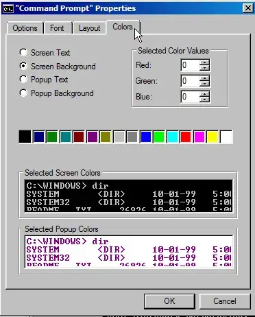

Open Command Prompt and right click anywhere along the top bar, then select Properties.
Navigate to the Colors tab, here you can select a new background colour (even a new text colour), there is a preview here too, so you can adjust it until it is most visible to your specific colour blindness.

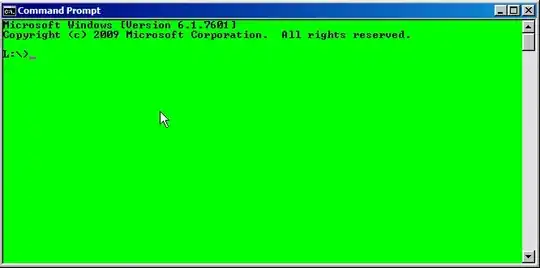

Here is an example of a more visible colour, it also makes your shell experience funky fresh!

I was having the same problem with red in my console.
I just discovered that if you change one of the palette colors it stays changed for that entry. So i changed my background to the dark red i could not read and changed it's RGB values to be much brighter. After appyling that I changed the background back to black and the dark red was now much brighter. I hope this helps somebody else, it has caused me al lot of frustration.
