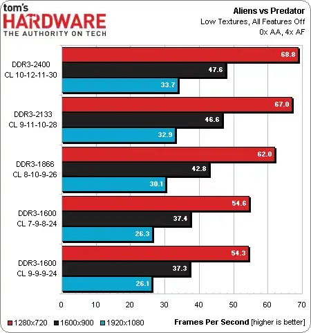

When you installed the second memory module, you enabled dual-channel mode and doubled memory bandwidth. GPU performance is highly dependent on memory bandwidth and your frame rates reflect the increase in bandwidth.
  • The AMD A10-6790K is an "Accelerated Processing Unit" (APU). APUs combine a CPU with a relatively powerful integrated graphics processor (GPU), eliminating the need for a discrete graphics card (at least for lighter workloads). "AMD Radeon HD 8670D" refers to the integrated GPU built into this APU.
  • The performance of any GPU is heavily impacted by its ability to quickly access graphical data from memory. Without sufficient memory bandwidth, the shader cores on the GPU will often end up waiting for data, preventing the chip from working at its full potential. It's essentially an extreme case of the von Neumann bottleneck: today's GPUs have hundreds, if not thousands of gigaFLOPS of raw processing power and can process data so rapidly that they often can't read data from memory quickly enough to keep themselves busy.
  • For this reason, today's high-performance video cards use specially-designed video memory, typically GDDR5, to achieve maximum performance. Unfortunately, most integrated GPUs, including those found in APUs, do not get their own dedicated memory, so they need to use the system memory instead.
  • Because AMD APUs use the system memory as graphics memory, integrated GPU performance is highly dependent on the speed of your RAM. Not only does DDR3 system RAM have significantly less bandwidth than GDDR5 video memory, the integrated GPU needs to share this bandwidth with the CPU for normal application use. Increasing memory bandwidth will directly increase performance by reducing this bottleneck.
  • When you upgraded your system's memory, you added a second memory module. With two modules, your memory now runs in dual-channel mode, doubling memory bandwidth and dramatically increasing performance as a result. Upgrading to faster RAM (at least DDR3-1866, preferably DDR3-2100 or faster) will similarly increase performance.
The effects of memory bandwidth on GPU performance are well-documented.
  • Real World Tech has discussed in detail how memory bandwidth affects GPU performance. Among graphics cards with similar or identical GPUs, those with more memory bandwidth were found to significantly outperform those with lower memory bandwidth.
  • Tom's Hardware has shown that integrated GPU performance on the A10-5800K scales linearly with memory bandwidth up to DDR3-2100. On the newer A10-7850K, PC Perspective reports linear performance scaling with memory as fast as DDR3-2500 (and likely beyond).
Tom's Hardware chart showing memory scaling with Aliens vs Predator
Source
  • In the Tom's Hardware and PC Perspective articles, the tests were performed with dual-channel memory configurations, so having a single memory module led to the severe performance bottlenecking you observed before you upgraded. It is readily apparent at this point that to get optimal performance with an AMD APU, you need the fastest memory you can get.
