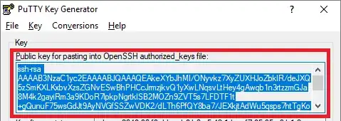

First you need get public key in a format for OpenSSH authorized_keys file.
Once you get the public key in the authorized_keys format, paste it to the "SSH public key" box, when provisioning Azure Linux machine (or when resetting the public key):
Martin Prikryl
  • 21,071
  • 77
  • 157
    That doesn't work. Azure goes through the initial stages of VM setup but then aborts complaining that the key is not X.509 compliant. – Alex R Jul 30 '14 at 18:49
    Ok, I followed the instructions at http://azure.microsoft.com/en-us/documentation/articles/virtual-machines-linux-use-ssh-key/ and they worked. Basically you run "openssl req -x509 -nodes -days 365 -newkey rsa:2048 -keyout myPrivateKey.key -out myCert.pem". The .pem needs to be uploaded via the Azure portal. (I'm not posting this as an answer because I did it on my Mac, and the poster asked for a Windows solution. Googling indicates that OpenSSL distributions for Windows exist, but I haven't tried any.) – Rohit Chatterjee Jan 29 '15 at 04:49
    Also, the private key generated in my comment above - myPrivateKey.key - needs to be imported into PuttyGen and converted to a PPK. Putty will not use the .key file. – Rohit Chatterjee Jan 29 '15 at 04:51
  • @RohitChatterjee That was all misunderstanding. OP asked about private key (giving an impression he want to use it as host key), while the question was actually about public key. I've updated my answer accordingly. – Martin Prikryl May 08 '18 at 19:38
  • Actually this is still a little off as I wanted to use WinSCP, not Putty. I'm going to edit the question one more time to make this answer correct. – Alex R May 08 '18 at 20:29
  • It's not off, as the procedure is the same for WinSCP and PuTTY. But anyway, I've added a note that WinSCP has its own copy of PuTTYgen, so you do not have to install it for this. – Martin Prikryl May 08 '18 at 21:02
  • Can you please remove your first comment starting *"That doesn't work"*? – Martin Prikryl Oct 19 '18 at 14:03
