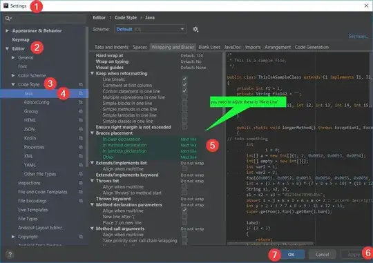

Here is the exact working path. I have added screenshot with explanations.
Screenshot "How to change braces position in Intelli
