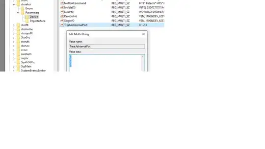

or Windows 10:
[HKEY_LOCAL_MACHINE\SYSTEM\ControlSet001\Services\storahci\Parameters\Device]
"TreatAsInternalPort"=hex(7):30,00,31,00,32,00,33,00,34,00,35,00,00
(Thanks to kinokijuf for the head-start, but his code Only disabled 1 drive for me (drive 0 on my 2nd controller).
This one worked for all 5 drives I have. (and probably the 6th too).
I think it was because there was a BLANK newline in between his values (00 in hex is newline), (30 in hex is 0, 31 is 1 etc).
This one worked on all 4 of my ports: screenshot
I need to block bus 0 and 3. I had to enter in hex 30 00 00 00 33 00 00 00 for the hex value. Problem solved.
  • This worked for me, but the location of was slightly different. I found it at HKEY_LOCAL_MACHINE\SYSTEM\CurrentControlSet\Services\storahci\Parameters\Device – Sasha Sep 19 '16 at 05:27

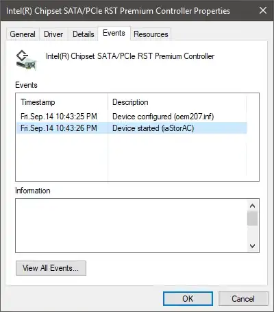

None of the methods I've seen online worked with my amd x570 setup. Partly because none explain how to know which driver is being used; and thus which registry key needs attention.
So here we go for Windows 10:
  1. In Device Manager expand either:
    • IDE ATA/ATAPI controllers
    • Storage Controllers
  2. Here you can open the Properties -> Events tab for whichever controller you are using:
    • Look for the registry key name after Device started
    • AMD Sata (amd_sata)
    • Intel RST (iaStorAC)
  3. With these names we now know which registry key to look for in HKEY_LOCAL_MACHINE\SYSTEM\CurrentControlSet\Services\
    • amd_sata, iaStorAC, storahci, secnvme, spaceport, etc...
    • you can tell a driver is in use if it has an Enum key inside
    • for me storahci has no Enum key so adding TreatAsInternalPort wont affect anything
  4. Now this is the tricky part as each driver looks for a different registry setting
    • amd_sata, hide 2 drives on port 0 & 1 required a setting of 3:
     [HKEY_LOCAL_MACHINE\SYSTEM\CurrentControlSet\Services\amd_sata\Parameters\Device]
    "AmdSataInternal"=dword:00000003
    • Use AmdSataExternal, alternatively, to force showing eject for drives
  5. What about my controllers' registry setting?
    • I'm sorry I don't know any others.
    • You may be able to find some clues or registry settings in different versions the driver's inf file
    • If someone knows of a way to get a driver to list its possible registry options and values that would be cool. (I imagine it involves analyzing the driver's sys files?)
Hopefully, this helps someone else stuck on this.
