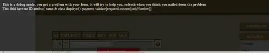

How would I go about setting up VirtualBox for this kind of environment?
pic
Just like real-life servers work. Have one server that receives the outside internet connection, has all the DNS, DHCP, AD... stuff and all the client PCs connect to it. I am unable to get the server (Windows 2012) and client (Windows 7) PC connected internally.
How should I set up the adapters?

  • I'd add, the image is MUCH too small to read. – Journeyman Geek Aug 07 '14 at 12:04
