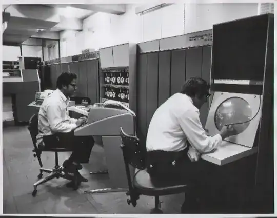

I was looking at information on early computers and noticed some had what appear to be circular CRT displays, such as in the following images.
Gerald J Sussman at PDP-6 and 340 Display from MIT Csail
People using PDP-6 from University of Western Australia Computer History Gallery
Was there any reason these displays were circular? Wouldn't a rectangular display be easier to draw to?
Early system that had circular displays like this included the PDP-1, PDP-6, and CDC Cyber 72. In particular, the one used in the PDP-1 and PDP-6 seems to be called a DEC 340, but I can't find any info on it.
While searching for information on these circular displays, I also came across some info that stated early radar displays were adapted from oscilloscopes and eventually developed into their more stereotypical circular shape. I also note that the Whirlwind 1 had a circular display. Could these be related to the origins of the circular displays on the systems I mentioned above?

  • I believe that those displays were not used as terminals, but purely for graphics (note the Teletype terminals in both photos). They would be *vector scan* displays, not *raster scan* displays. – sawdust Aug 09 '14 at 06:32

  • @Prasanna I may have worded my question badly, especially with the inclusion of me asking if a rectangular display is easier to draw to. I am not necessarily looking for an opinion. I want to know if there was a particular reason that these computer displays were circular, rather than the more common rectangular or square displays. However, there seems to be a lack of information on early circular displays, so there may not exist any hard facts about why they are circular. In this case, I would look for someone knowledgeable to provide some speculative insight into why these are circular. – Dorik Aug 09 '14 at 06:50
  • A circular CRT screen means better beam control and less geometric distortion with less cost. – sawdust Aug 09 '14 at 07:41
  • Televisions, prior to about 1955, often had circular picture tubes. The tradition of specifying picture tube size via the diagonal measurement comes from the round tubes. – Daniel R Hicks Aug 21 '14 at 21:44
  • While a rectangular arrangement is obviously better for text, for graphics use (radar images, oscilloscopes, display of graphs, et al) the round shape was often better, and at the very least not objectionable. – Daniel R Hicks Aug 21 '14 at 21:47

The displays are described here:
There was also a high quality DEC 340 CRT display unit with a round, ten-inch screen which could draw simple vector graphics, and an accompanying light pen could be used to draw on the display screen.
As for why they were circular, I would expect that it was because that was the natural form factor for early cathode ray tubes. It was, for example, typical for older oscilloscopes to have circular screens.
The programming manual for the 340 display is available here (PDF). Despite the round appearance, the manual states that the programmable region is square:
Points may be plotted on a 9-3/8" square raster centered on the face of the display tube.

  • *"Points may be plotted on a 9-3/8" square raster"* -- the use of the word "raster" is misleading here, since it is a vector display. That manual goes on to explain that *"the electron beam does not scan the face of the tube; its position is determined by the contents of the x and y registers of the display."* – sawdust Aug 09 '14 at 07:36
